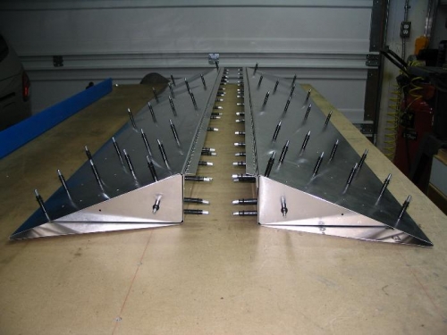

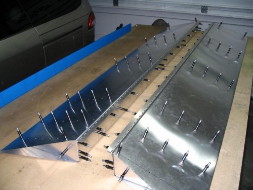

Perhaps because of being tired from recent travels and concerned about messing up my hinges (not cheap), I took my sweet time today in all things hinge related. I used my horizontal bandsaw to cut the hinges to the proper length. When it was time to place the hinges, I took pains to put the bottom of the hinge 3mm from the web of the flap bottom. That took quite a bit of measuring and checking, but worth the effort. The hinges look good and operate well. Now on to deburring, priming and riveting to complete my flaps.
The inboard ends
The inboard ends
Hinges in place and ready to deburr and rivet
