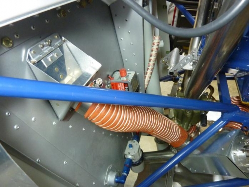

Brief Description:  Installed cabin heat valve
Installing the cabin heat valve was the last step in setting up the air intake/distribution system to the carb and cabin. Very straightforward installation of the part sold by Van's Aircraft. The normal position of the valve is open, allowing air to be drawn through the valve when carb heat is called for.
Cabin heat valve mounted on firewall
SCAT hose to cabin heat and carb heat out of heat exchange muff
