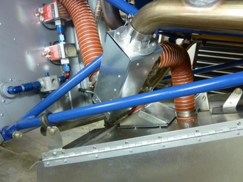

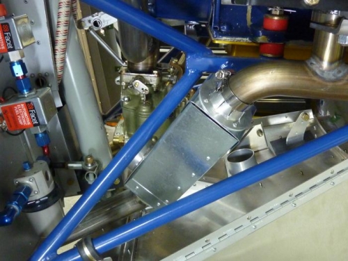

Tonight I shortened the length of the box to 7" to account for the need to have more straight exhaust pipe to which I could clamp. Going the full 7.5" impinged on the radius of the pipe. I then slid the first end cap on the exhaust pipe, then the box, and finally the remaining end cap. At that point I riveted everything together and then reinstalled the exhaust pipe. In position, I was able to turn it for maximum clearance and the best alignment for connections. The rest of my time was spent cutting and fitting SCAT hose. I still need to put mounting hardware on the air fliter box, so it has no clamp yet.
The muff in place
The muff in place
Set up with SCAT hose

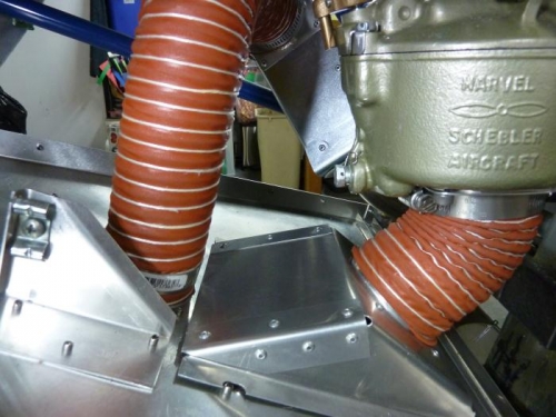

Carb heat hose on the left and air filter to carb hose on right
