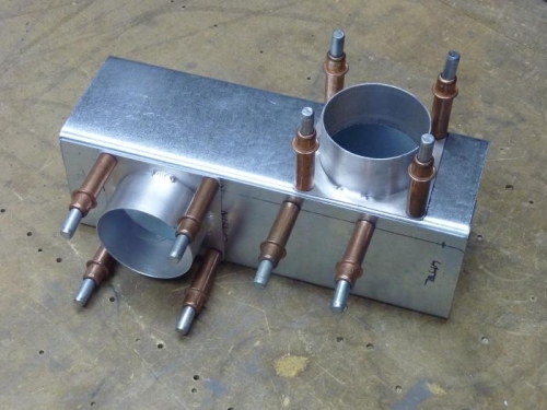

Brief Description:  Fabricated heat exchange muff
In order to provide heat to the carburetor (to prevent carburetor icing) and to provide heat to me (to prevent Larry icing), you need to install a heat exchange muff around an exhaust pipe. It needs to be made of either stainless steel or galvanized metal. Because of price, I chose the latter and today I formed the outside of the muff. Tomorrow I hope to make the two ends and complete the installation.
The muff with a duct flange to cabin heat (left) and carb heat (right)

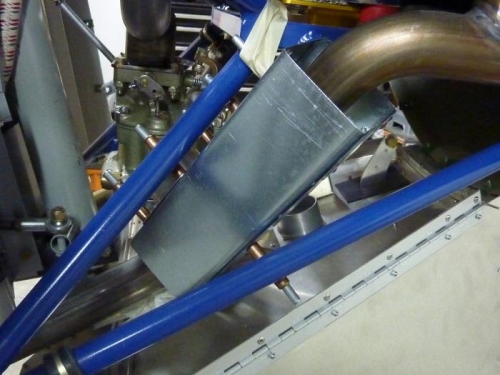

Approximate placement nestled between the engine mount tubes

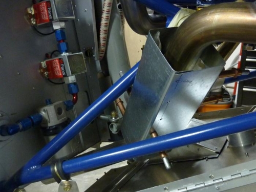

Another view
Another view
