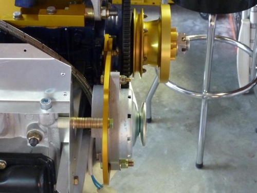

Brief Description:  Moved alternator forward and mounted vertical baff

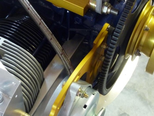

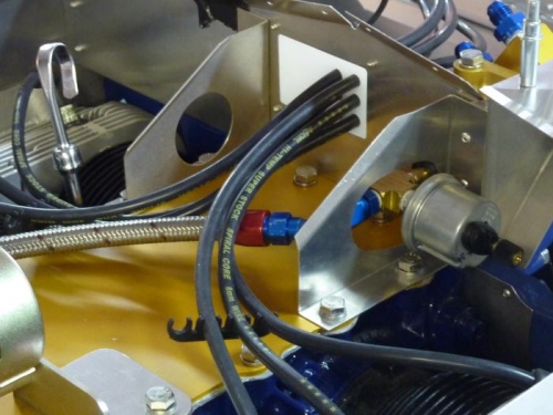

After shooting an email to the Corvaircraft email list, I confirmed that the alternator bracket needed to be in front of the "dog bone" when one has installed a 5th bearing. Otherwise, the alternator and prop hub pulleys are out of alignment. Because of tight quarters, this took more time that you would think. I then primed and mounted the vertical baffle supports, coating the top cover bolts with Permatex Ultra Grey. The bolts were then torqued to 10 foot/pounds. I also replaced the oil pressure sender, sealing the threads with Permatex High Temperature Thread Sealant. Finally, I did an inventory of my hose fittings in preparation for installing the oil cooler.
New alternator alignment
Bracket in front of the
Bracket in front of the "dog bone"
Riveted and mounted
Riveted and mounted
