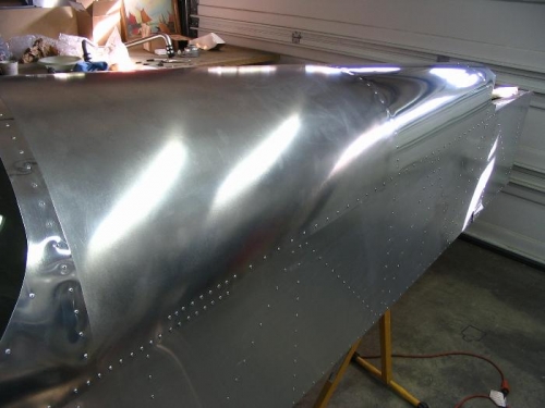

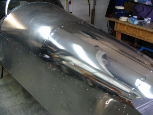

Brief Description:  Polished back left qtr of rear top skin
My experience from previous polishing work is that some aluminum from some manufacturers is more difficult to polish than others. As you might have guessed, this is some of the worst. The good new is that once it gets a shine, it really holds it. The bad news is that it took a total of 20 applications of F9 and full buff outs, plus 3 with C compound to get the shine you see. I can only hope that the side skins are from another source!
One quarter done with rear top skin
Easy to see the difference in shine
