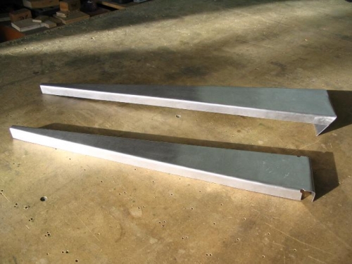

Brief Description:  Remade rudder rear ribs #1 and #2
On looking back at my technique, I just wasn't pleased with my rear rib #1--the largest rib. It had deformation from my clamping and hammering technique, so I decided to remake it. Since I made the other rib -- #3 -- I have decided to go with .025" skins, so I decided to do all the ribs in .025" as well. This is factory approved, and should give the rudder a substantial feel and rigidity.
Remade ribs
Remade ribs
