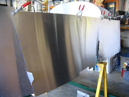

Brief Description:  Side skins cut for spar & gear openings
This step was pretty straightforward. After clamping the side skins level with the top of the upper longerons, it was time to mark around the spar and gear channel from the inside. Next, I just confirmed the dimensions of each part before cutting. I drilled each corner to produce a clean corner and radius, and then used the Olfa knife to complete the cuts. Things fit perfectly and look good to me.
Left side cut for spar & gear openings
