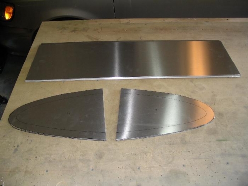

Brief Description:  Rough cut nose and wing rib blanks
I laid out and rough cut all the form blanks for the nose and wing ribs. Next step is to position and drill the middle holes for all flanges to insure final placement, then mark the flange lines and cut.
