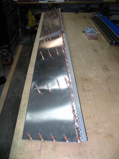

Brief Description:  Ailerons ready to prime and rivet

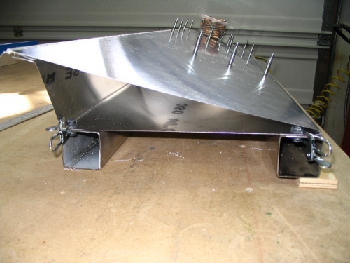

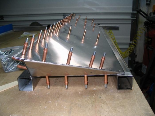

Completed left aileron to the same level as the right one (pre-drilling but no tip rib or hinge placement). Set the washout angle, placed the hinge and the tip ribs, drilled and clecoed them. With everything in place, I drilled to the final size (#30 for A4 rivets). Finally I deburred and pre-cleaned all the parts.
Using the spacer to set 13mm washout
Tip rib in place and clecoed
Both ailerons ready for deburring
