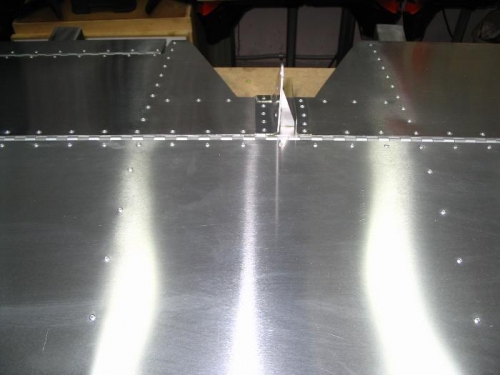

After a 12-day break for preparation for my quarterly board meeting, I was able to finish the empennage. I really took my time in locating the hinge, so neither side would bind. The hinge works perfectly, so the change of direction was well worth the effort. I also adjusted the servo rod to be 120mm from pin to pin (instead of 115mm on the plans). This seems to give me the maximum range in both directions. I ran the 5-wire cable through the grommet in the front of the elevator and soldered all five leads inside to the servo wires. With a quick test, I was able to determine that everything is working just fine. Now if I just had space on my walls, I would have something really cool to hang up. In any event, I can now consider the empennage complete.
Everything riveted except the fiberglass tips.  That happens after mounting the tail to the fuselage.

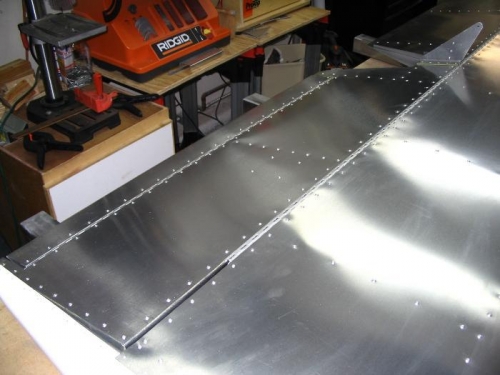

Trim tab with servo connected and wired

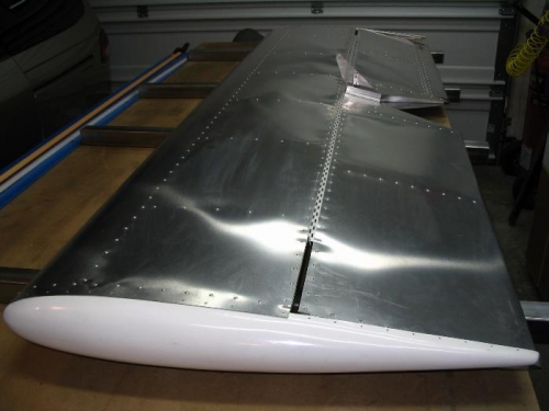

Elevator horn and rudder cutout
