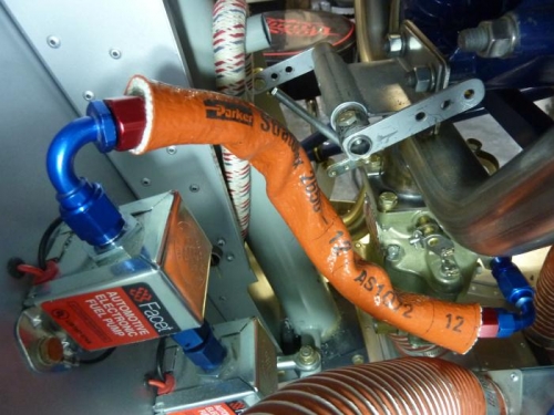

Brief Description:  Installed fuel lines in cockpit and to carb
I think the pictures tell the story fairly well. I fabricated the two hoses needed to go from fuel selector to firewall, and from the fuel pumps to the carburetor. What I didn't have was an Adel clamp to attach the long hose to the cockpit side of the firewall. I'm also missing two hose clamps to secure the firesleeve to both ends of the hose from pumps to carb. Otherwise, the fuel system is virtually complete.
Fuel line from pumps to carb, with firesleeve ready to clamp
