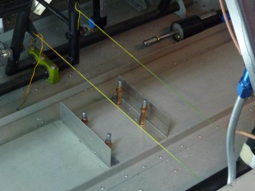

Brief Description:  Fitted floor angle support for center console pane
I carefully determined the vertical alignment of the future rudder control cables and then moved the side panel supports out 15mm. Then I drilled and clecoed the angles to the floor. I spent some additional time removing 8 previously installed but now unecessary nutplates from the center console side panels between the two seats. These will be re-used in securing these two new side panels.
L angles in place
L angles in place

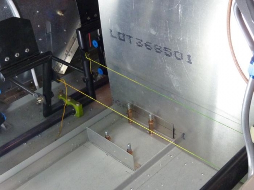

Showing clearance between rudder cables and panel

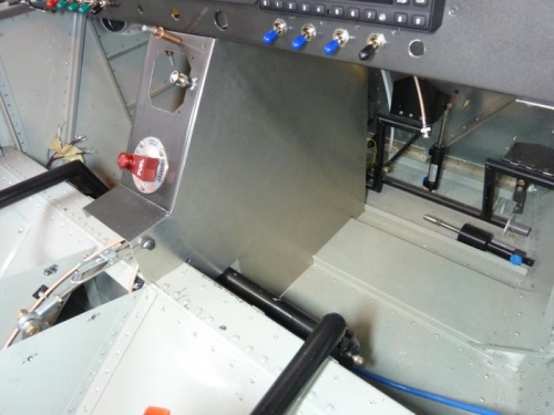

Final alignment
Final alignment
