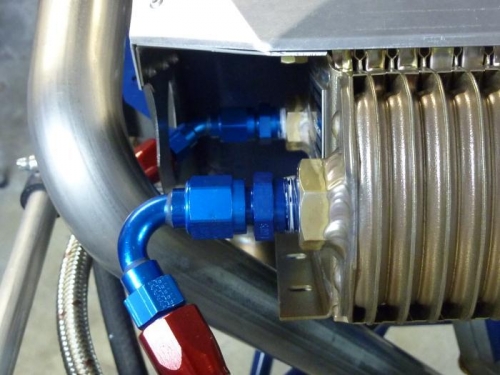

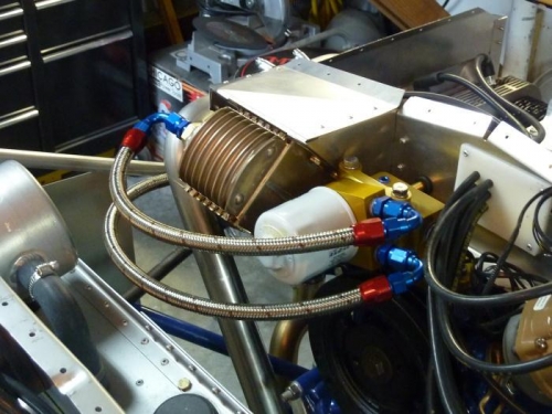

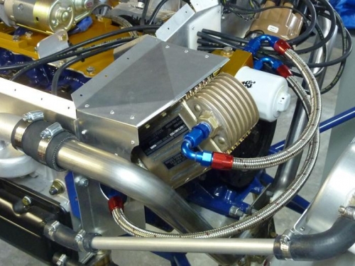

Brief Description:  Installed oil lines to cooler
Once I determined the best angle for for oil system sandwich adapter, I torqued it to 35 foot pounds. I routed the oil lines in such a way that I could remove the oil filter without having to move the lines. As you can see, I used three 120 degree fittings and one 45 degree fitting coming from the lower port on the cooler.
Oil lines installed to Niagara cooler
Side view
Side view
120 and 45 degree fittings coming out of cooler
