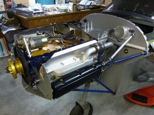

The first thing I did tonight was complete the fabrication of a .020 thick patch to cover the opening in the left rear heat shield. You can see this by looking down into the oil cooler baffling in the 3rd picture below. I also sealed it with Permatex Ultra Grey. Next I connected the hoses from the left valve cover to the oil/air separator. The bigger accomplishment was to locate and drill the baffling for the oil cooler. With just a little trimming on the back to widen the opening (thereby exposing all the cooling fins), I should be ready to drill and bolt in the cooler and run my oil lines to it.
Oil cooler baffling clecoed in place
Front view
Front view
Looking into the back where the oil cooler will be mounted
