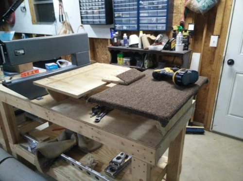

Brief Description:  Manufactured Table for Dimpling Tool

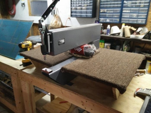

Built table for dimpling tool. covered table with carpet to protect the finish on the aluminum. Used a 2 litre soda bottle filled with led shot to hold carpet down while glue dried. I used a 3M spray adhesive to secure carpet to top. I folded the edges of the carpet down underneath table and stapled them.
Table half of table covered.

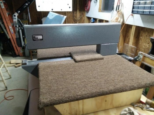

Finished table
Finished table
