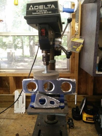

Brief Description:  Mounting Cut and Polish Wheel on Drill Press
I took the 3M cut and Polish wheel off the bench grinder and mounted it on the drill press. I switched the belt to the Fastest pulley setting 3100 RPM which is just a little bit slower than the bench grinder. It is much easier to use this set up for bigger pieces.
