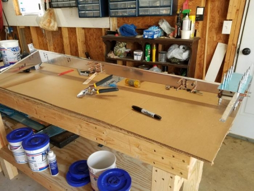

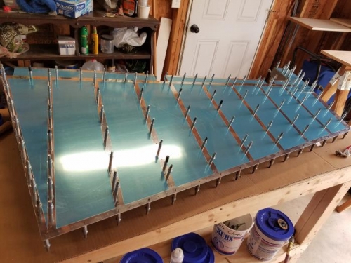

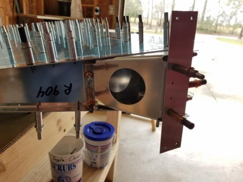

Clecoed rudder skeleton, skin and horn
Clecoed Rudder Skeleton, Clecoed rudder skin to skeleton, Match drilled all #40 holes, Clecoed rudder horn and horn brace to rudder spar and lower rib. match drilled all holes.
