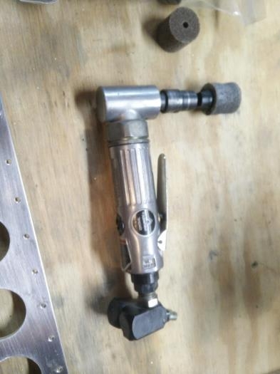

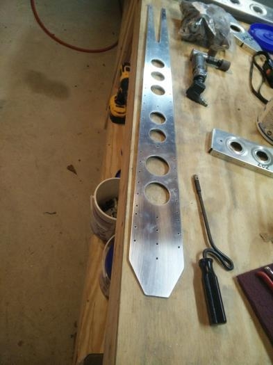

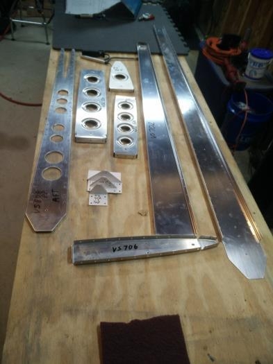

Deburred the vertical stabilizer doubler, ribs, forward, and aft spars. Used 3m cut and polish wheel chucked in driff press for most edges. The ligtening holes I used a smaller 3 m wheel in a die grinder. The rivet holes I deburred with a deburring tool.
Vertical Stabilizer Frame parts
Doubler & deburring tool
die grinder & small 3m wheel
