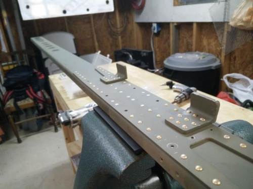

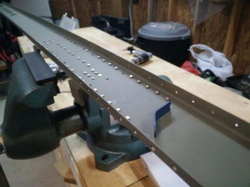

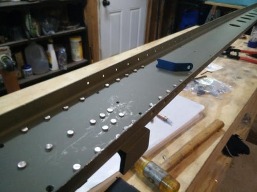

Date:  9-27-2017
Brief Description:  Riveted Front Spar, Doubler, Spar and Attach Angl
Riveted Front Spar Doubler, and Attach Angles to Front Spar, Making sure to leave holes for Ribs open. Used Pneumatic Squeezer and Rivet Sets. Used Rivet Gauge to check the shop head side of the rivets.
