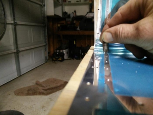

Used die grinder and 3M disc for deburring some rough spots on edges. I used the dog leg deburring tool for deburring the #40 holes on the R/H Skin, R/H Spars, and R/H Main and Nose Ribs. In the bend of the skin where I could not fit the deburring tool. I unscrewed the bit from the end and used just the bit to deburr the holes.

Using Deburring Bit
Using Deburring Bit

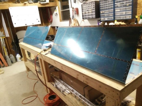

Deburred HS skins
Deburred HS skins
