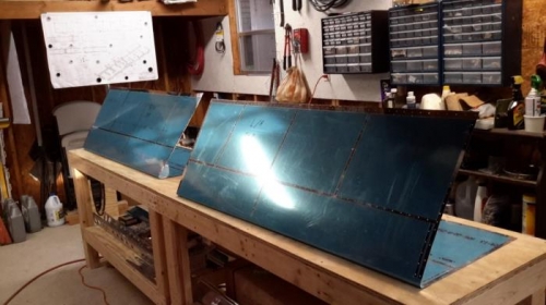

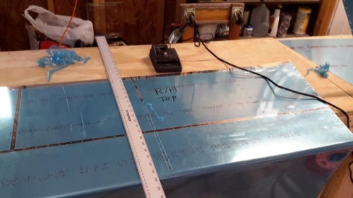

Used a Soldering iron to remove strps of the protective film from the Horizontal Stabilizer Skin. Deburred all the #40 holes on the nose ribs, main ribs, front and rear spar flanges and bottom L/H side of Horizontal Stabilizer skin.
Removing Coating with soldering iron
Film removed
Film removed
