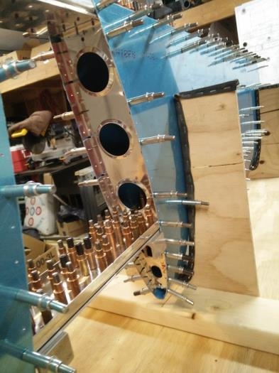

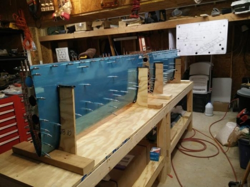

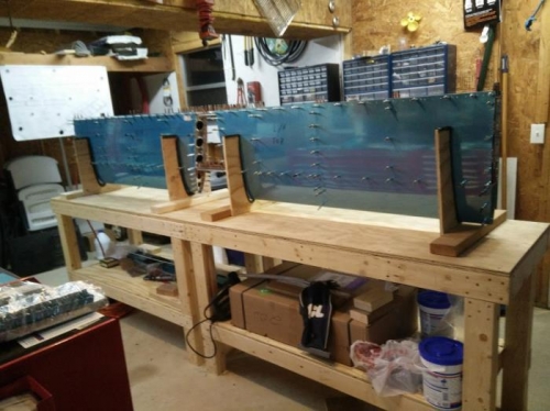

Brief Description:  Assemble Right Horizontal Stabilizer in Jig
Inserted HS901 skin in jig. Clecoed the HS 905 nose ribs to the skin. Fluted the forward web of the most inboard nose rib for proper fit. Clecoed the Right forward HS902 Spar and HS907 doubler to the skin and nose ribs. Clecoed the HS904 main ribs to the front spar and skin making sure the HS 909 shim is used on the forward side of inboard main rib. Clecoed the HS903 left rear spar and doubler to the main ribs and skin.
