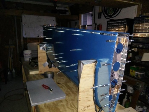

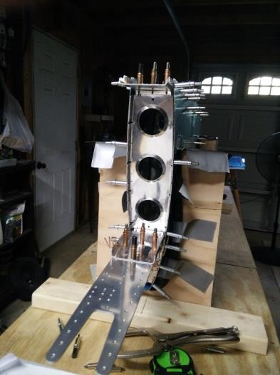

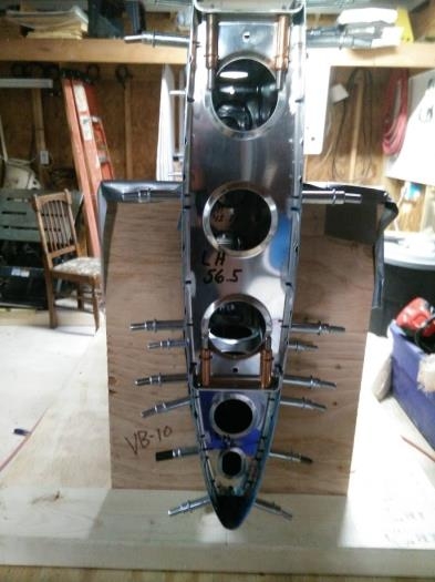

Brief Description:  Assembling Horizontal Stabilizer in Jig
Labeled HS 901 Skins Left and Right to designate which side it will be used on. Inserted HS901 skin in jig. Clecoed the HS 905 nose ribs to the skin. Fluted the forward web of the most inboard nose rib for proper fit. Clecoed the Left forward HS902 Spar and HS907 doubler to the skin and nose ribs. Clecoed the HS904 main ribs to the front spar and skin making sure the HS 909 shim is used on the forward side of inboard main rib. Clecoed the HS903 left rear spar to the main ribs and skin. The left Horizontal stabalizer is now ready for the skin to be match drilled up to #40.
Inboard Left Horizontal Stabalizer

Outboard Left Horizontal  Stabalizer
