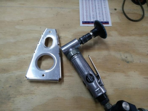

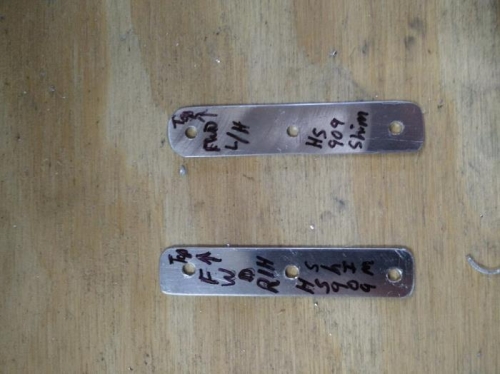

Used 3m Cut and Polish wheel to clean up the burs and edges on the rest of the HS904 Main Ribs and the HS905 Nose Ribs. Used angle die grinder with 3m ultra fine polish discs attached to clean up the cut outs and corners on the Main Ribs and Nose Ribs that I could not get to with the bigger Cut and Polish wheel. Fabricated HS909 Shims and match drilled.

Cleaning Nose Ribs
Cleaning Nose Ribs
HS 909 Shims
HS 909 Shims
