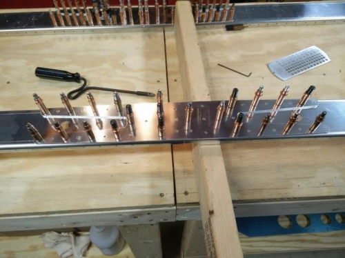

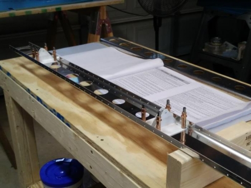

Clecoed HS 908 Rear Spar Doubler Plate to the HS 903 Rear Spars. Match drilled 1/8" holes enlarging them to #30. Clecoed the 8 HS 912 Outboard hinge brackets to the Rear Spar.
Rear Spar Doubler
