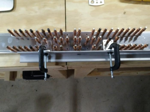

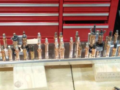

Match Drilled HS 908 L & R attach angles. Enlarging 1/8 hole in angles to #30. I was able to drill 8 of the 9 holes. The bottom middle hole was covered by the C clamp. I used draw clecoes to hold everything in place and took off C clamp to drill last bottom middle hole.
C Clamp & L angle
C Clamp & L angle
Match drilling HS 908 L&R
Draw Clecoes
Draw Clecoes
