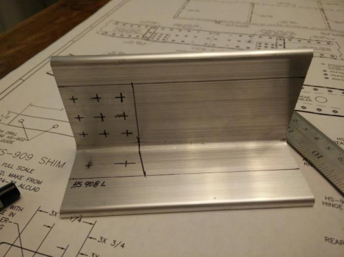

Brief Description:  HS 908 Attach Angles

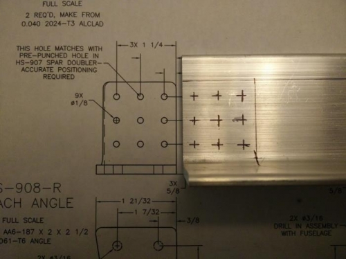

Using the plans Drawing #3. Laying out the HS 908 left and right attach angles. I used my dial caliper, a ultra fine tip sharpie, and a ruler to lay out the cut lines and mark the holes to drill. Even though I marked the two holes on the smaller part of the attach angle these holes do not get drilled at this time. They will be drilled in Assembly when all parts are lined up. The only holes that will be drilled are the 9 on the larger piece of the attach angle. After I had layed out the lines on the angle I used the drawing to verify that they are correctly marked.
HS908L

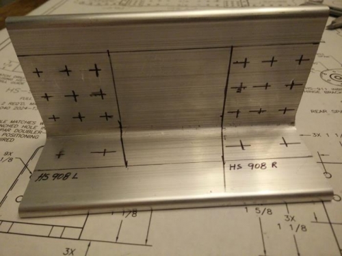

HS908 L&R
HS908 L&R
HS 908L Hole alignment.
