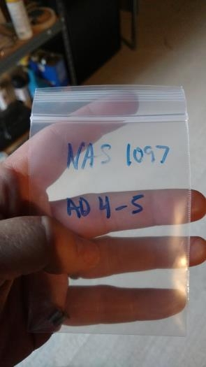

Another Sonex builder noticed that I had missed installing some rivets on the main spar tunnel, and was kind enough to tell me about it.
At first the news was very dissapointing because I thought I was going to have to drill out 100 or so rivets, but yet another builder in my EAA chapter came up with a solution. I contacted Sonex tech support, and was told that it would be an ok fix.
I ended up buying some solid flush "oops" rivets. They have shaft size of the next larger rivet, but the same size head as the one you presumably messed up.
You can see from the pictures that there are no longer missing rivets.

"oops" rivets
