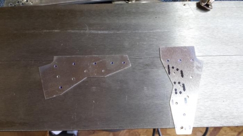

Worked on the gussets for the forward and aft wing ribs.
After measureing and aligning the first piece, I was able to use a marker to mark the bending brake. This sped up the process quite a bit since I only have to measure the first piece.
Marked hole locations on bending brake
Using holes alignment circles

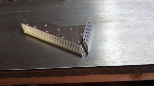

Completed Gussets
