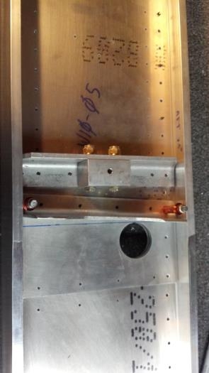

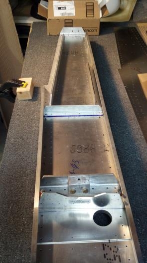

Spent some time this morning mounting another attach block and various stiffeners.

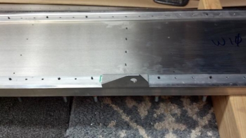

The plans say the spar caps can have up to 1/16" of one of flanges left. I decided to not remove any more than I had to. It's less work, and maybe a little stronger. Unfortunately, the wing tie down must be bolted flush, and the extra material is in the way at this spot. Looks like it's time for the file, and sandpaper.
Wing tie down
