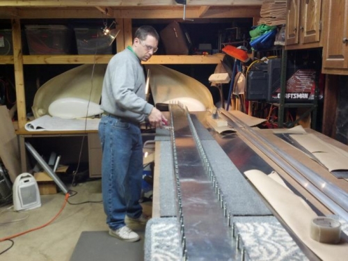

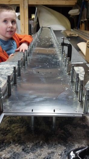

Finished drilling pilot holes for the right hand spar caps.
Deburred both sides of every hole in the spar caps.
Reassembled spar caps to main spar web, and added the doublers.
I'll probably updrill the spar caps to #30 tomorrow, then start on the left hand spar caps.
Finished pilot drilling both sides
Deburred and added doublers
