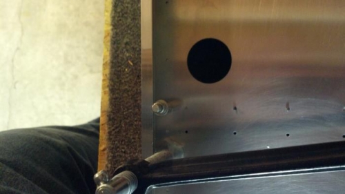

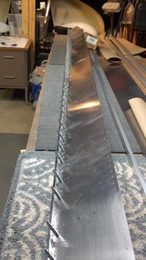

Brief Description:  Pilot drilling right top spar cap
Using a "brand new" #40 drill bit and some cutting fluid, I drilled the first pilot hole in the top right spar cap. I'm very pleased with performance of this new drill bit. The ones I bought before wanted to walk to the side before they would start drilling.
I didn't count number of holes I drilled, but near the end I was very liberal with the cutting fluid -- it helped a lot.
The spar cap spacers that came with the kit worked great, and made a somewhat difficult process much easier.
First Hole Drilled!
First Hole Drilled!
All Pilot Holes Drilled in TR Cap
