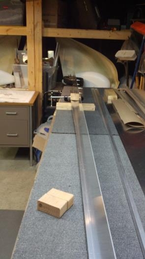

Though not picutured here, Sonex provides laser cut spacers for setting the positions of the top and bottom spar caps in relation to the web. I had forgotten about them at first, and was scratching my head trying to figure out how I was going to get them position correctly from the references provided on the print.
I notice I need some deep throat clamp. I'll plan on picking some up tomorrow. I'm also supposed to get the 0.2470 reamer soon.... Speaking of which, I'm seeing a lot of "tight fit" callouts for AN3 bolts on the main spar assembly. Wouldn't want this to be too easy :-)

Clamping main web to spar cap
