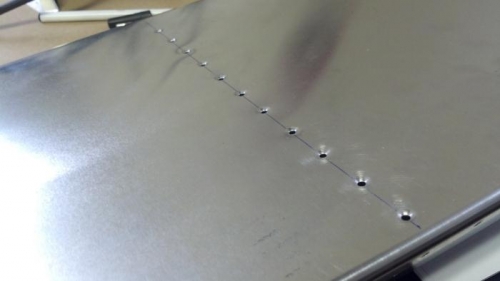

Spent some time drilling and dimpling. Everything lined up pretty well. The only issue I had was that the three sides of the elevator tip aren't in a perfect plane, as ideally they would be. This would have caused one of the hinges on the piano hinge to not be lined up with the rib. Fortunately I caught the discrepancy and was able to shift the drilling location by approx. 1/16”.
Dimpled on elevator skin

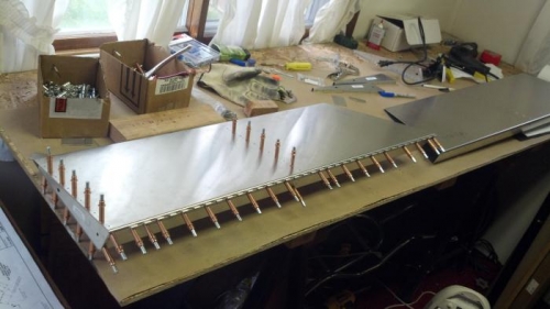

One Dimpled one Queued
