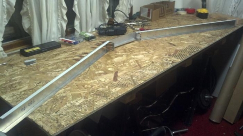

I finished fabricating the horizontal stabilizer forward spar assembly today. It still needs to be smoothed, primed, and riveted, but it still feels like another big step is finished.
This assembly wasn't really that difficult, but it did require some careful measuring, and premeasuring. almost all the measurements are referenced from a particular hole per side. However, one of them was referenced from the leading face instead of the hole. I didn't notice it as soon as I should have, so it caused a lot of head scratching. Fortunately I didn't cut or drill anything until I had this figured out.
