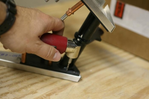

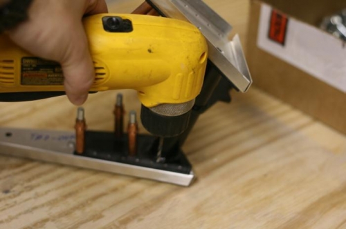

The elevator control horn was my first piece. I had some trouble drilling the rivet holes trough the pre-drilled pilot hols of the control horn and rib because my right angle drill was too large. This caused me to make one of the pilot holes offset by about 1/64". I bought a right angle adapter and some "stubby" bits. This made drilling the rest of these holes very easy. Step drilling up to 1/8" and some carefull reaming made the hole nice and round, and still small enough to rivet.
You'll notice that 3 hours seems long for clamping preformed parts and some drilling. Well the preformed ribs weren't perfectly formed, so I had to adjust the bend angles. The short bend was pretty far off, and I didn't notice that it was supposed to be more than 90 degrees until after I had already drilled holes in the rib. It's hard to explain, but I had made the short bend flush with it's corresponding edge of the control horn assuming the rib's flange would extend past the edge. Once I realized that this was incorrect, and bent the angle correctly, I discovered that the rib actually extended 1/32" farther than ideal, maybe a little less. This is probably well within tolorance, but will keep this in mind during assembly of the elevators.

Right Angle Drill Too Big
Got Right Angle drill Adapter
Elevator Control Horn Drilled
