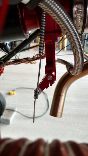

Brief Description:  Adjusting mixture lever
I had some issues with the mixture. First, the cable I bought was too thick to fit through the retaining slot of the AeroInjector. The manual said the slot could be reamed to accomodate a larger cable, so that's what I did.
The second issue I had was the cable binding on the the lever arm. When I would tighten the swivel fitting, the cable wire would interfere with the lever arm. I ended up narrowing the lever arm to allow the fitting to freely swivel when fully tightened.
