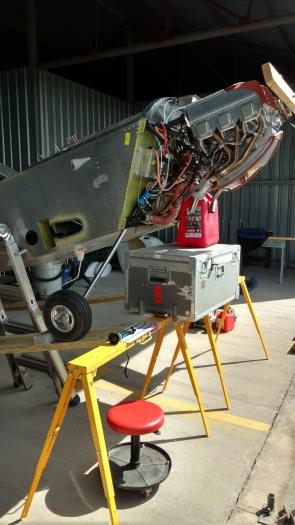

Brief Description:  Fuel Flow Testing
I performed fuel flow testing. The good news is that the fuel flow is more than the engine requires with minimal fuel, the bad news is that it is 130% instead of 150%.
With 10 gallons in the tank, I get 17 GPH, which is way more than I need.
While testing fuel flow, I was also able to verify that my fuel flow sensor is very accurate.
I contacted the builder who's fuel system I copied, and he said that he thougt I was fine, and that with the engine running, the vaccuum in the intake would help the fuel flow as well.
Fuel Flow Testing
Fuel Flow Testing

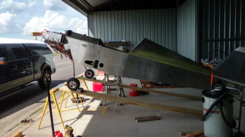

On the
On the "ramp"
