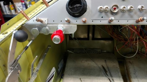

In stalled a curtis oil drain valve on the oil sump, and added about 3.7 quarts of oil. While safety wiring the valve, I pulled too hard, and it came loose. Unfortunately the copper washers were already compressed, so I had to retighten it. If this happens again I'm going to have to get new copper washers. So far it's leak free. That's not saying much, as it's just sitting still, and at room temp.
Most of the engine monitor wiring is now finished. I still have to install the radio, and ELT before I clean up the wiring though.
I decided to work on the control cabling, and I think I like the way the cables are looking. for the primer, and carb heat cables, I plan to use a 3/16" compression fitting on the firewall.
Throttle, Primer, Carb Heat, and Mixuture
