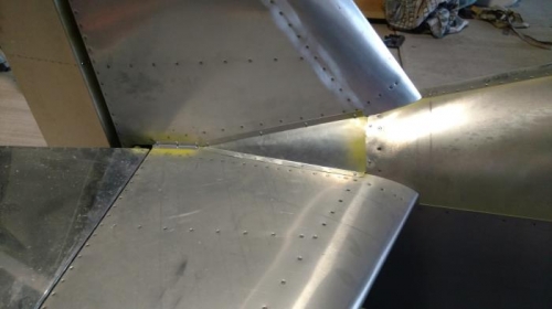

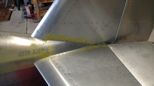

Brief Description:  Fabricating and installing tail and cable fairing
I fabricated and installed the tail fairings according to the plans. They turned out OK, but I realized afterawards than since they aren't structural, I could have annealed them by heading them up with a propane torch, and letting them cool slowly. This would have made bending them to shape much easier.
Though not pictured here, I used the annealing proceedure to fabricate custom cable fairnings. They turned out very nice. One of them looks like it was purchace from a professional vendor.
