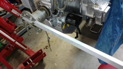

I made a cheater bar to keep the prop flange from turning while I removed the 6 cap screws. This was the most nerve wracking part of the process. If I broke one of the cap screws, the crank shaft would probably have to be removed, and possibly replaced…thousands of dollars.

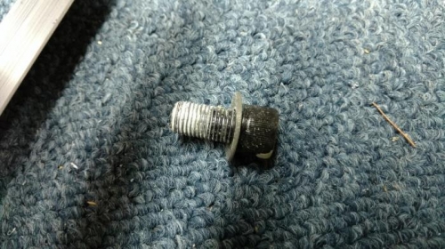

To make removing the cap screw a little easier, and safer, I heated the prop hub with a heat gun until it was almost too hot to touch. Doing this softened the Loctite, and I was able to break the cap screws loose without cracking them.
