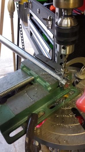

Drilling Titanium Rods
Drilled mounting holes in my titanium landing gear. It wasn't bad, I just had to run the drill press at a low RPM, clear the bit often, and use lots of WD-40
260 RPM and WD-40
