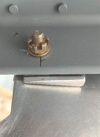

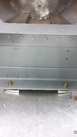

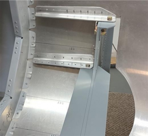

Installed the center wing panel.
Note: the original design calls for a bolt to go thru each of the bottom (external) longerons and the bottom cap strip of the center wing panel. Due to the geometry of the skin line (curved) and the spar (straight and thru the fuselage), tightening (torquing) these bolts requires either the spar or the longeron to deform. I'm not fond of that idea so tapered spacers were machined. Once installed, any deformation during torquing the bolts will be minimal.

Mounting angles place the spar
A close up of a wedge
Both sides ready to torque
