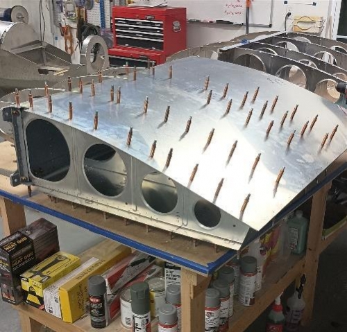

Brief Description:  Match drilled the center wing section
Was able to match drill the left top side of the center wing section. Had to work out a way to drill into the rib flange as without support the pressure from drilling would bend the flange enough to create an oblong hole.
