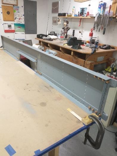

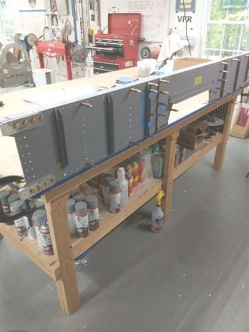

Completed assembling and riveting the wing center section.

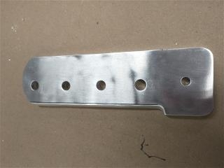

Then fitted the outer wing panel mounting brackets. They have to nest in the radius of the angle aluminum spar cap; additional material needed to be removed from the bracket to ensure a non-interfering fit in the cap.
Riveting the caps is complete
All bolts torqued
All bolts torqued
Material below the line needs to go
