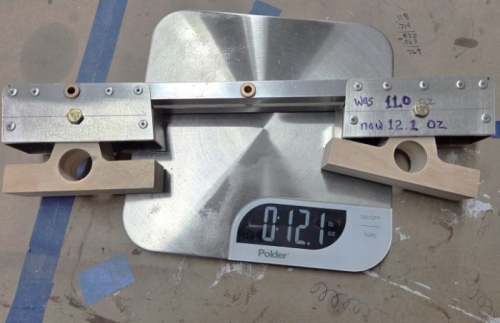

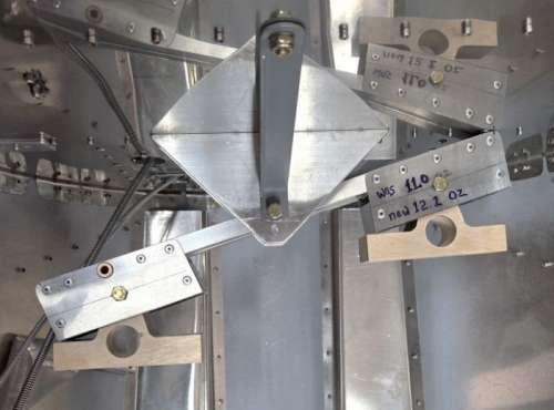

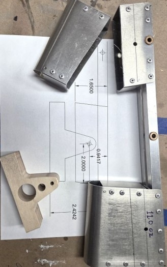

When installing or attempting to install the choke and throttle cables I decided to fit check me in the cockpit for the first time. I was really enthralled with the rudder pedals - 1. I didn't have enough leg room and 2. each pedal canted inward, which, for me, was uncomfortable.
As you can see, the comfort mod cost only 1.1 ounce.
So - an enhancement was in order. I hope the pictures tell the entire story.
