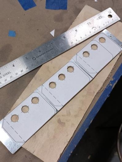

Once the pitot-static tubes are in, it is time to begin thinking of how to route and manage the lines in to the cockpit. Laying out brackets to perform the "manage the lines" then had to be done.

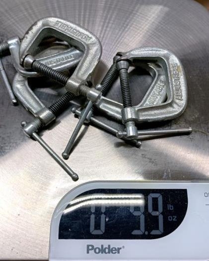

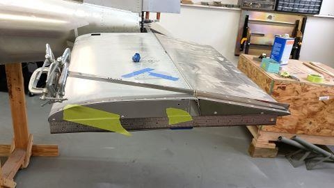

Comment - as read previously the load on the elevator stop was really heavy and I decided to counterbalance the elevators just because that is a good practice and would reduce the load on the stop bracket - a lot!
Routing brackets
Routing brackets
Balancing the elevator
It took 9.9 oz to balance
