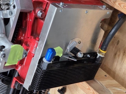

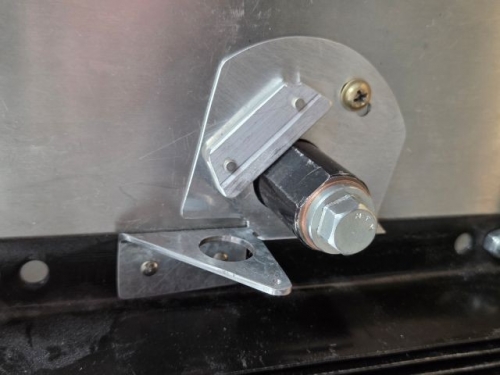

Locking mechanism for oil drain
Because I had concerns that the "as received" engine did not have any anti-rotation consideration for the oil drain extension nor the drain plug itself, I added both.
