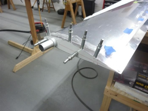

Laid out, drilled and riveted the trailing edge of the right flaperon.

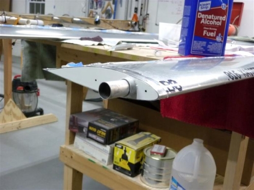

Fitted, laid out, and drilled the inboard end rib of both flaperons. Epoxied and riveted the left end rib in place right during a power failure and decided to wait until tomorrow (assuming the power returns) to epoxy the right one. (Note: added the centerline holes that facilitate pulling out the end rib, via the clecos during the fitting.)
Riveting the trailing edge
Fitting the end rib, note centerline clecos

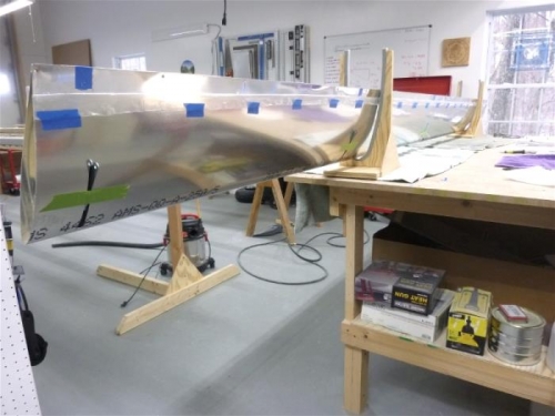

All done!!
All done!!
